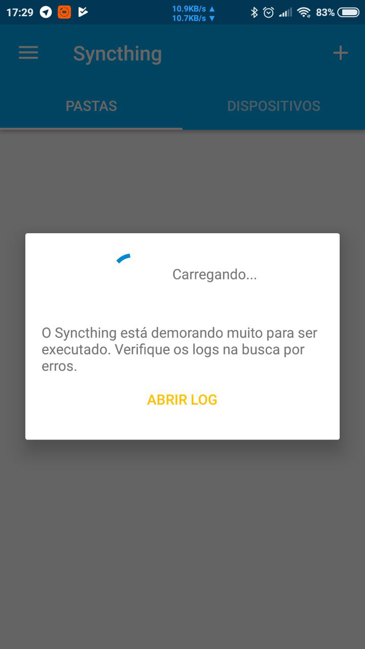

[Android] After 0.10.16-beta1 update this happens.
Okay, so I was happy about to use the app and this showed up on the 1st run:
  1. After the 1st run, and the setup wizard, it goes to this:
  1. I switch tasks and after opening the app again it keeps on that screen forever, won’t let me open the material menu or the plus sign.
  1. On WiFi tethering it shows me this message:
Within the settings…
Then, after opening the settings, even I toggled everything on/off, it keeps showing the message and hangs on the main screen forever.
  1. After a while, I decided to connect to my router again and it showed me this option:
Here’s a fragment of the activity log. I pasted only the lines that repeats a lot on it. The rest is all redundant.
Activity log (fragment, click to view)
--------- beginning of main
01-16 17:29:21.332 W/SyncthingNativeCode(24196): 2019/01/16 19:29:21 http: TLS handshake error from 127.0.0.1:42793: remote error: tls: illegal parameter
01-16 17:29:21.337 W/SyncthingNativeCode(24196): 2019/01/16 19:29:21 http: TLS handshake error from 127.0.0.1:42794: tls: client offered an unsupported, maximum protocol version of 302
01-16 17:29:21.341 W/SyncthingNativeCode(24196): 2019/01/16 19:29:21 http: TLS handshake error from 127.0.0.1:42795: tls: client offered an unsupported, maximum protocol version of 301
01-16 17:29:21.554 W/SyncthingNativeCode(24196): 2019/01/16 19:29:21 http: TLS handshake error from 127.0.0.1:42796: remote error: tls: illegal parameter
I didn’t try on other devices yet. I just need to transfer some important data from the PC to the phone. If it helps, I’m on a Xiaomi Redmi Note 4X running MIUI 10. Here are further details:
Just tell me if I need to roll back to the stable release, post it on GitHub or somewhere else.
Oh, not to forget that this discussion is also on Telegram. (Link)
PS: Don’t mind the Portuguese UI. I just wanted to make this quick. But the visuals must be enough to recognize the error. :grin:
Thanks for the help.
