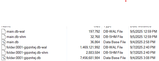

here are the file sizes.

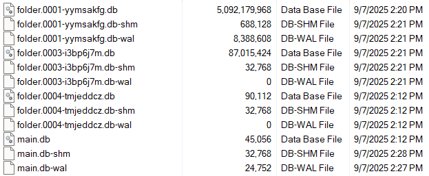

For reference, here are the file sizes on the working node.
