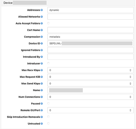

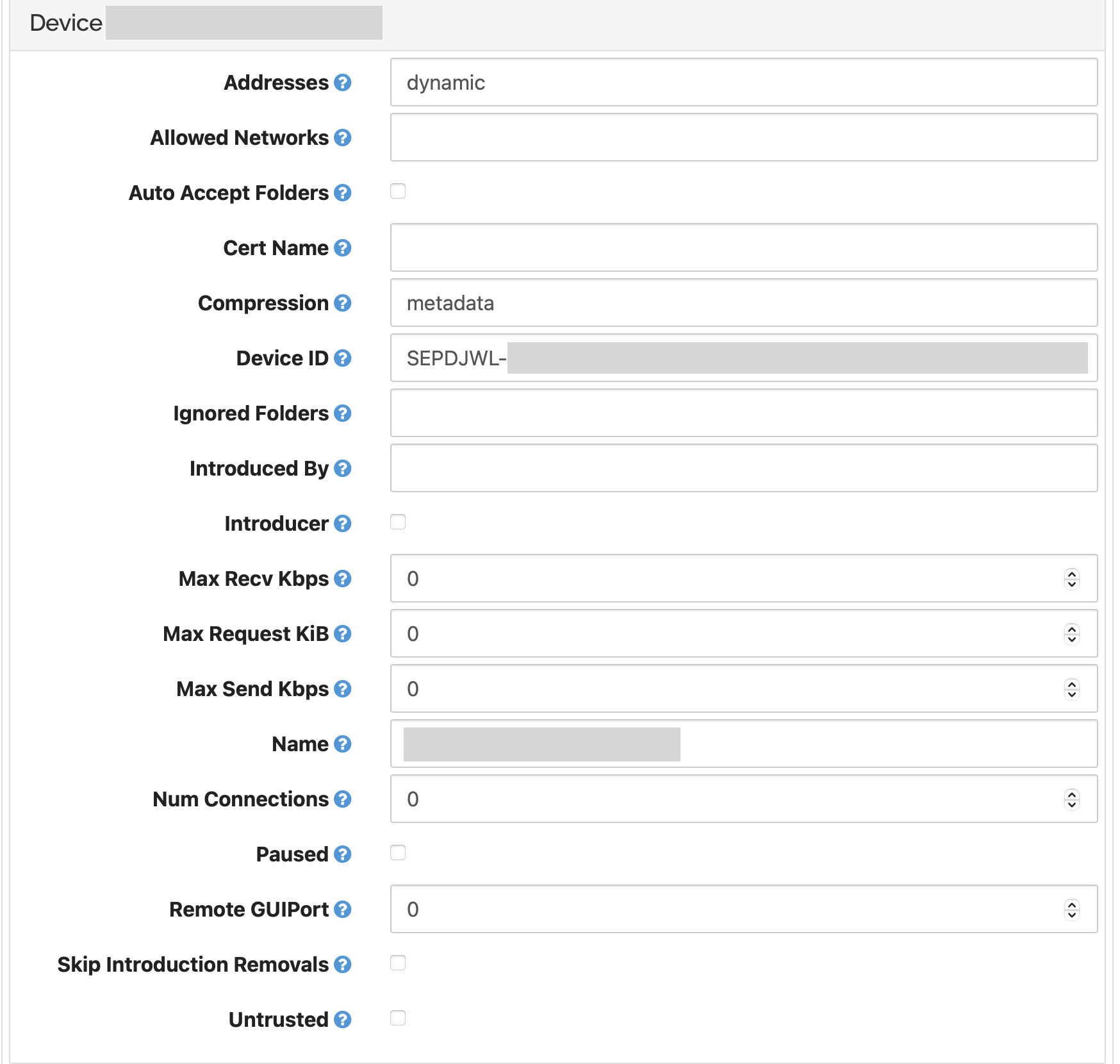

What are your settings regarding multiple connections? By default in Syncthing v2, it should be set to 3, however in your log there are some crazy numbers recorded.
Yes, that. If you can take a goroutine trace / support bundle when it’s in this state that would be helpful as well.
Generally speaking, what it’s waiting for is for folders to cease doing what they’re doing and become idle. That can in some cases be a little while (on the order of a few seconds), but apparently something pathologic is going on here.
Hundreds of connections per device won’t help, one of the things a folder might be waiting for is outstanding requests, not sure those are hard cancelled. In which case there may be hundreds when there are this many connections.
Yes - I saw those connection counts, and was wondering about those. At this stage I wasn’t sure if was the same connection count as had been increased in v2.
To the best of my knowledge I’ve not made any changes to the number of connections - for example, here are the settings for one of the noted devices:
