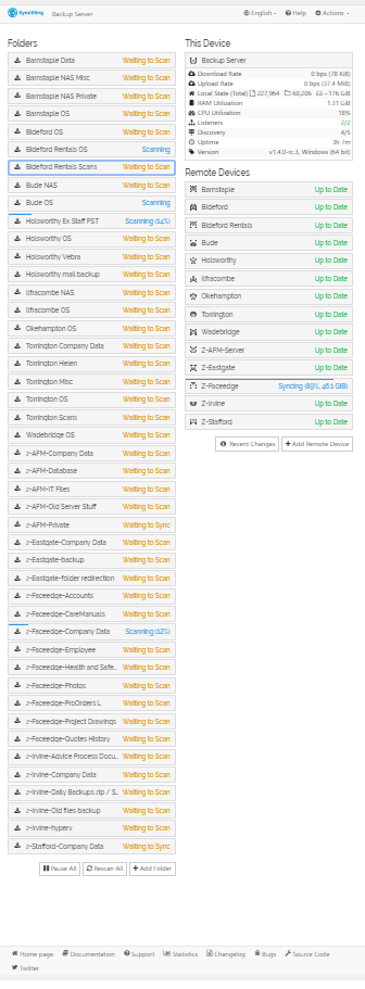

On the recent releases, the GUI now has waiting to scan. What the criteria behind to when it decides to scan or not? All these are receive only, rescan once a day (86400 minutes)
On a St restart some random folders start scanning, most do not. I can’t seem to run a scan on any job or ‘rescan all’. St has been running for 3hours and most have not started…
I have read #5914 which talks about concurrency, but is that limitation hard coded? I would like some flexibility on the number of jobs running. In the example above, all the jobs are spread over 3 drives but only 4 running, with the rest not started, eg…
