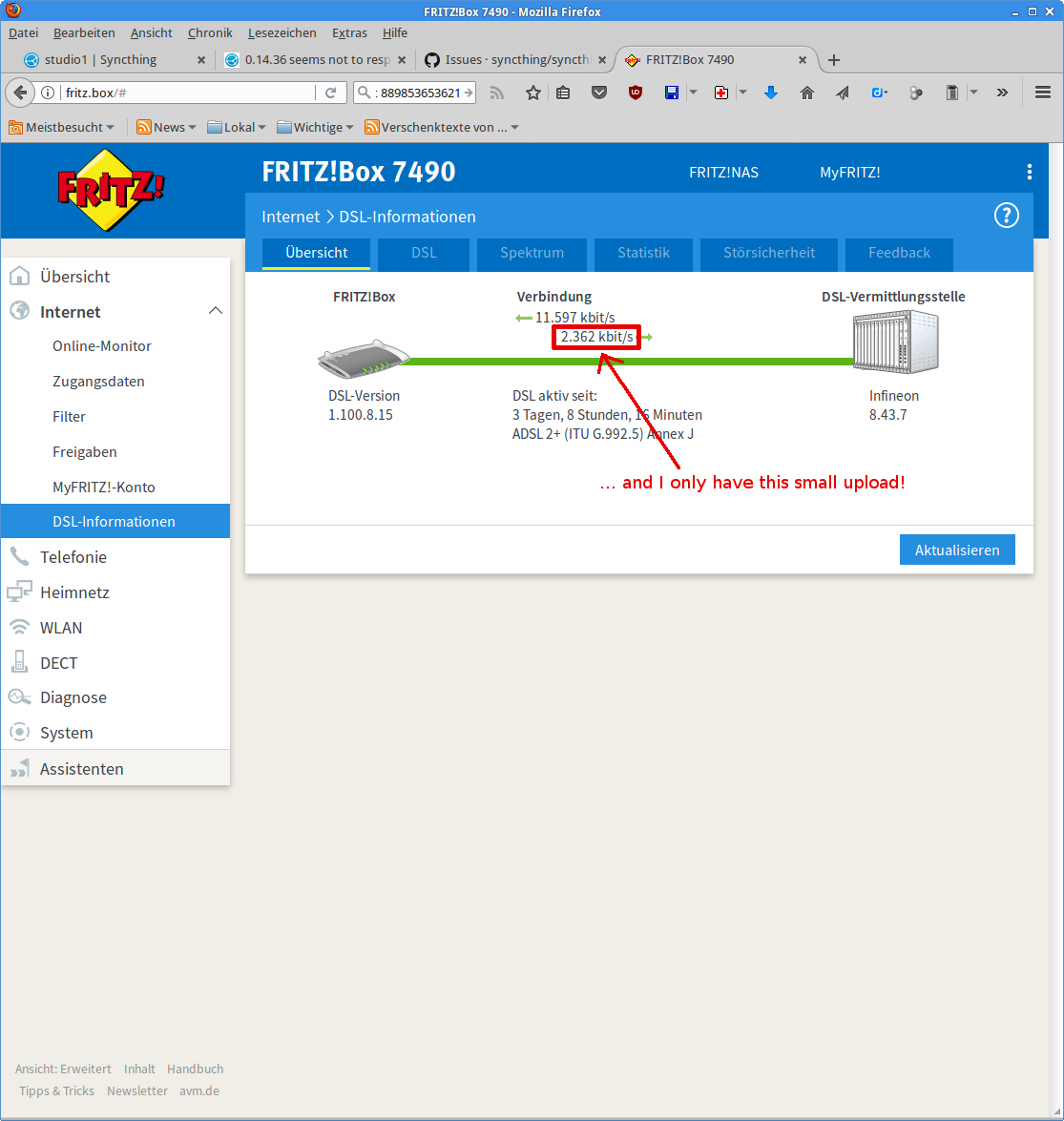

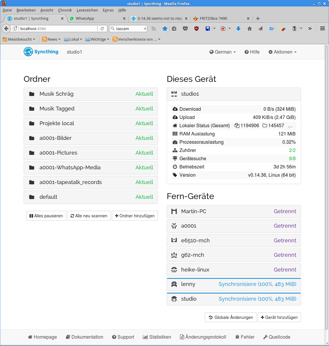

Here’s some more info. The GUI shows upload rates of up to 7.60 Mbps while I only have 2.362 kbps!
“studio1” system: Syncthing 0.14.36 OS: Ubuntu Studio 14.04.5 LTS
“lenny” system (remote): Syncthing 0.14.36 OS: Linux Mint 17.3/Cinnamon (based on Ubuntu 14.04)
Browser: Firefox 54.0 (64-bit)

I actually went and checked on my Fritzbox (unfortunately I can’t check the other one) and it seems to eat up around 2.000 kbit/s constantly, with slight deviations, effectively leaving enough headroom for doing something else (like a 128 kbit/s stream using IDJC).

Syncthing GUI when transmitting one big video file (~513 MB) for testing to both “lenny” and “studio”.
Global “Upload” switches between ca. 10s of “0 B” and 6–8s of too high KiB/s, like 409 KiB/s in this screenshot, ended by a short (maybe tenth of a second) value that lies BELOW the specified limit.

10s — 0 B
6-8s — 409 Kib/s
1/10s – 205 KiB/s
10s – 0 B
6-8s — 613 KiB/s
1/10s – 210 KiB/s
and so on

Today, with the Firefox update to v55.0.2 (64-Bit), the GUI responds correctly again, i.e., shows between “205 KiB/s” and “218 KiB/s” permanently (instead of jumping).
So maybe it really was a problem with Firefox’ new “multithreading” system after all.
