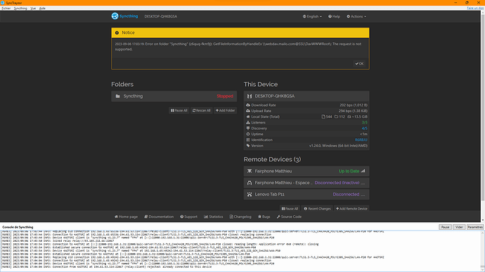

I’ve been using syncthing to synchronize a folder I access on my desktop through webdav to an Android phone and an Android tablet. It was working relatively well for the past two months. I hadn’t launched SyncTrayzor in a while and my tablet and phone synced fine with each other but the syncing stopped right away on my computer because of this error :
WARNING: Error on folder “XXX” (xxxx): GetFileInformationByHandleEx \webdav.mailo.com@SSL\DavWWWRoot: The request is not supported.
I have no clue as to what that error means nor how to solve it. Any help is appreciating since I have no idea what to do.

Can you provide more details on the specific OS version (is it fully updated?) and Syncthing and SyncTrayzor versions too? A screenshot with the error visible with more context would be useful as well.

The error is just saying that it’s not possible for Syncthing to get any information about the status of the folder, because the WebDAV layer says that information is not supported. I would ask why on earth you are pointing Syncthing to a folder that is mounted from your phone via WebDAV, but that’s of course your own business… Nonetheless I’m not surprised that there are problems.

Anyhow, no, I don’t have any more information really, I’ve never seen the error, but the gist of it is that Syncthing is saying “tell me information about this directory” and the WebDAV server or WebDAV client is saying “directory? I don’t know what you’re talking about” and Syncthing is unhappy. How come it worked before? No idea, sorry.
Syncthing generally works best with local storage, that is, files stored on the same computer Syncthing is running.
I guess a more sensible / less problematic architecture would be to have a local folder with your data, point Syncthing to that and have some other tool synchronize the same local folder to your WebDAV storage. (Sorry I don’t know such a tool from the top of my head, but there certainly are many.)
Synchronizing a remote WebDAV folder via Syncthing means that for every operation like scanning for changed content, Syncthing needs to communicate a lot back and forth with the WebDAV server. So it is less performant and comparatively fragile. If something is changed on your WebDAV server side, Syncthing might stop working suddenly for no apparent reason.
