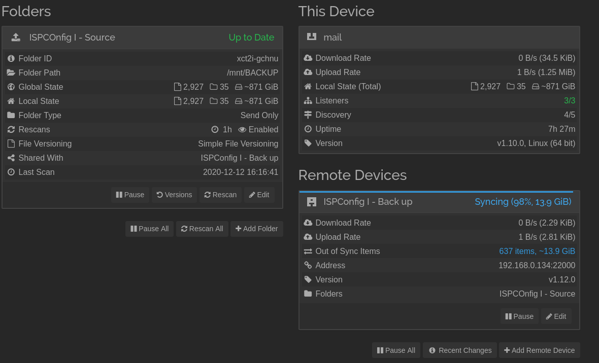

Here are screen shot (mail-Syncthing) of the server based (web).It shows which folders are used from the local folder(server based) and desktop remote folder (linuxmintsyncthing)
Folders are assigned for each one.
When the two were connected, it is NOT because I added it, it is because syncthing on the server detected the desktop csyncthing and asked me to add it.
The folders(it grabbed the folder name when asI are shared, but when I look at the “remote” folder, I was unable to find a place where the folder IDs are noted. I looked in the remote section and pressed edit to see the connection details. No sign of an folder ID is noted.

The folder in the syncthing-gtk screenshot has a different ID (i25d4-…) than the folder on the device “mail” (xcl2i-…). I’ts weird that there are out-of-sync items, however for that:

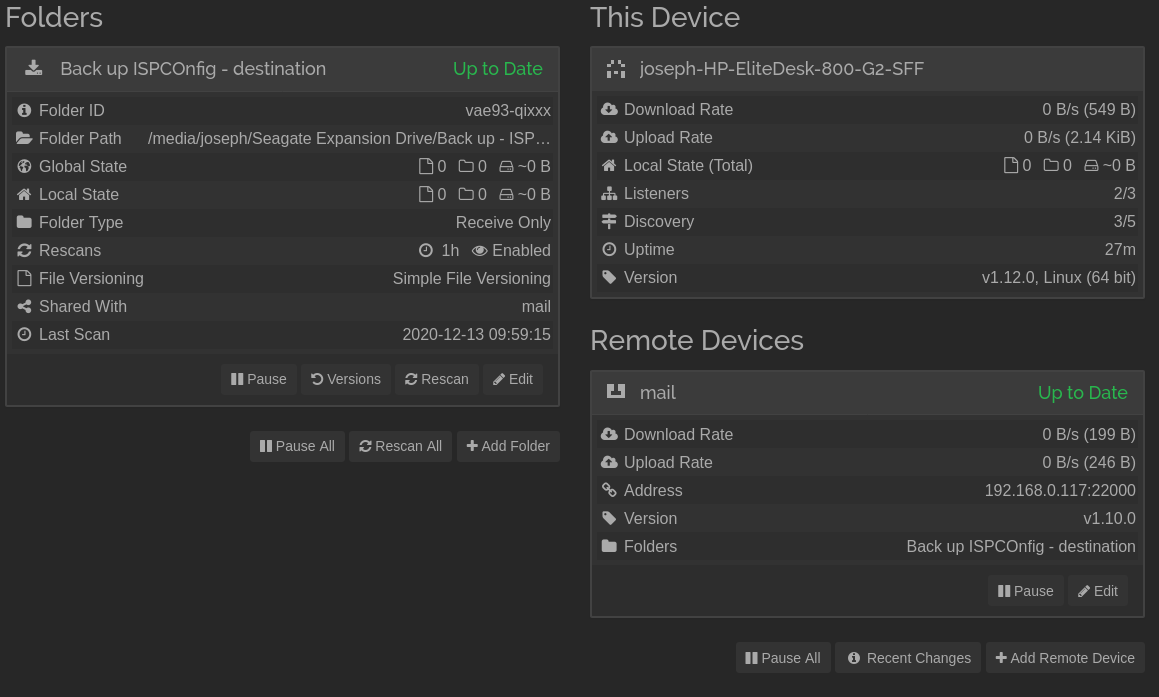

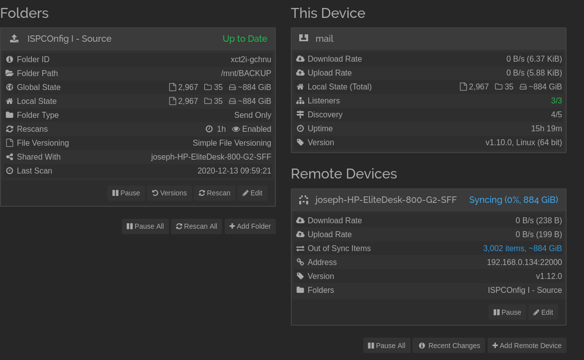

But, synchronization is not happening. I have uploaded the main screens of each one.
What might I be missing?
Same thing as before: Folder IDs don’t match.
You have two options:
  1. Create the folder on both devices with the same ID.
  2. Create the folder on one device, share it with the other. On the other, wait until the notice appears asking whether you want to add the folder and then do so (ID is the same automatically).

I got it!
It was the folder ID that I was not doing correctly.
