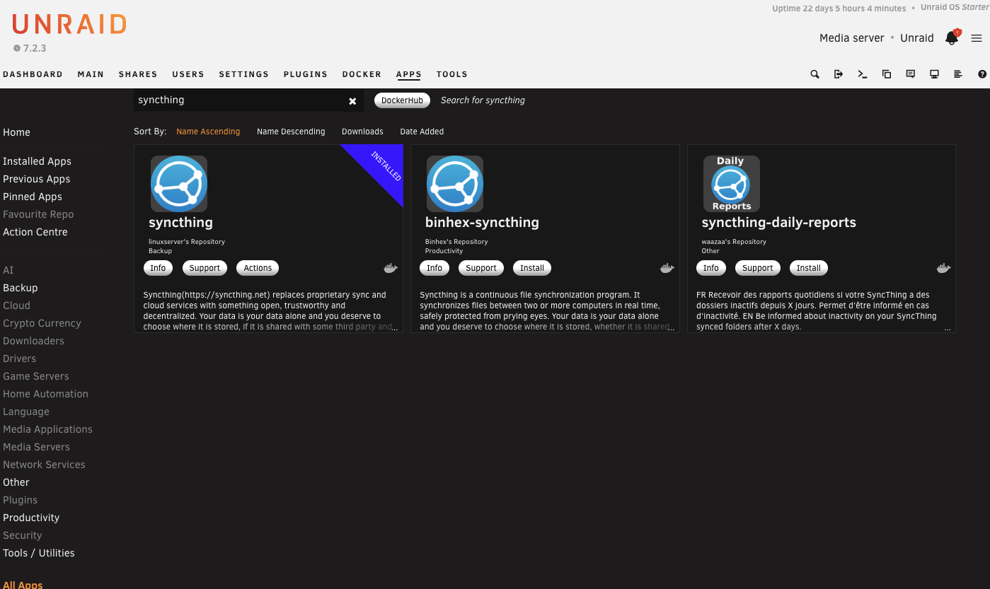

I’m on unraid 7.2.3 and using the Docker app based on the lscr.io/linuxserver/syncthing repo.
:roll_eyes:
I strongly recommend switching over to our image: syncthing/syncthing - Docker Image
Is there an app for that in Unraid?
We’re listed on Dockerhub. No idea why it’s not part of the search results.
I suspect these images might be specifically done for Unraid.

Re. the image source, Unraid Community Applications does not automatically index everything on Dockerhub as they need additional configuration for Unraid. Somebody needs to make a Community Application template that points to the official docker.
