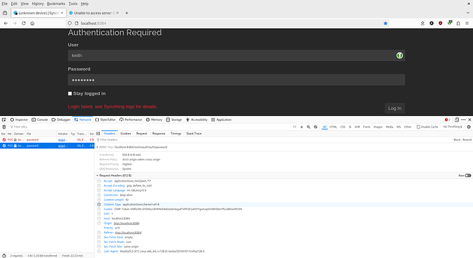

I’ve said this many times now, but if anyone could get a view of the failing request in a browser network debug console that would be helpful. @garyez01 made a valiant attempt, but unfortunately it doesn’t say anything useful. Perhaps another view or another browser might get something more.
Alternatively and additionally, running Syncthing with api tracing enabled (STTRACE=api) may add some additional debugging from Syncthing itself.
To clarify, I’m looking for something like this:

Getting closer; that’s the request headers. What does the response look like?

also tried on edge browser, there is no response packet, edge says ERR_EMPTY_RESPONSE firefox says ns_error_net_reset
I’ve got nothing in response. It literally says No response data available for this request
