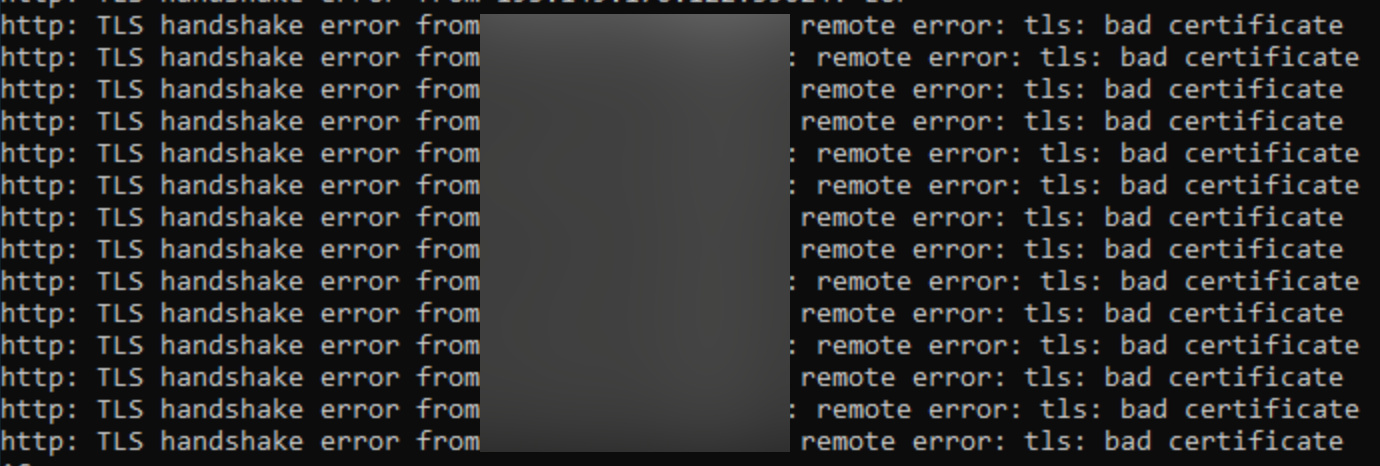

just tried all the combinations I got it all working apart from this message when I try to use own discovery server in the Global Discovery Servers instead of default, again I will probably use default in the future but just curious to get it working.
Discovery server is now started and firewall is opened and I see in the logs that one of my remote PC is trying to connect to it from its WAN ip address and I see this message (related to certificate)
I have opened port 8443 in the firewall… Btw here is the command I have used in win to start the Discovery server:
C:\stdiscosrv-windows-amd64-v1.23.4>stdiscosrv.exe -cert=./cert.pem -key=./key.pem
trying to use default certs
Well obviously your TLS certificate needs to be valid, but isn’t. You could try with Let’s Encrypt. Not sure how I solved that part actually, it’s been some time.
