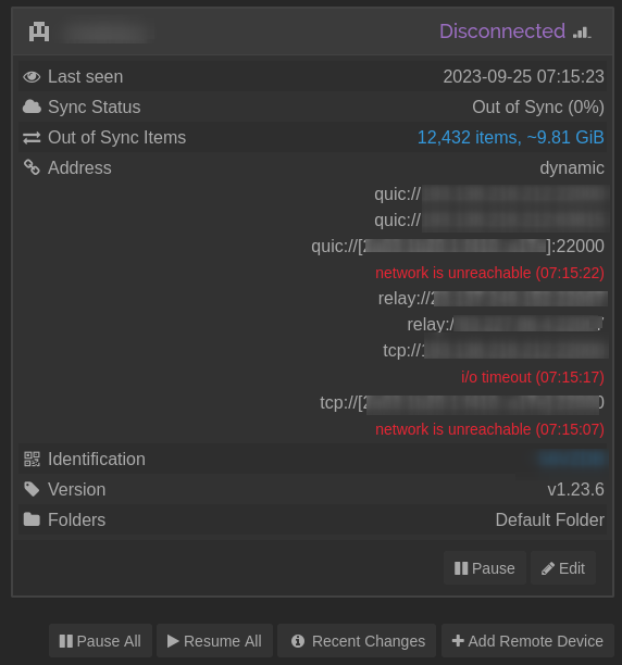

You’re connected through a relay server in that screenshot, thus all traffic goes through the open internet. Said the two devices were in the same room? So you should be able to connect them directly via LAN. Check the firewalls on both, maybe preventing a direct connection. While they’re disconnected, you can see a list of addresses tried, including error messages for each that failed. That might give you a hint why direct connections fail.
Overall it seems like your internet uplink is unstable, dropping the connection to the relay server regularly. Might be worse when the VPN is involved.

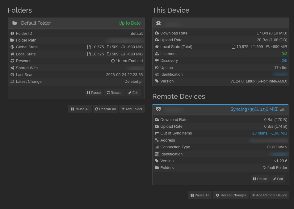

Please post full screenshots of the Syncthing Web GUI on both sides. If there any “Failed items” listed in the folder on the receiving side, please click on them and include a screenshot from there too.
Thanks a lot for chiming in to help!
Here is the Desktop GUI:

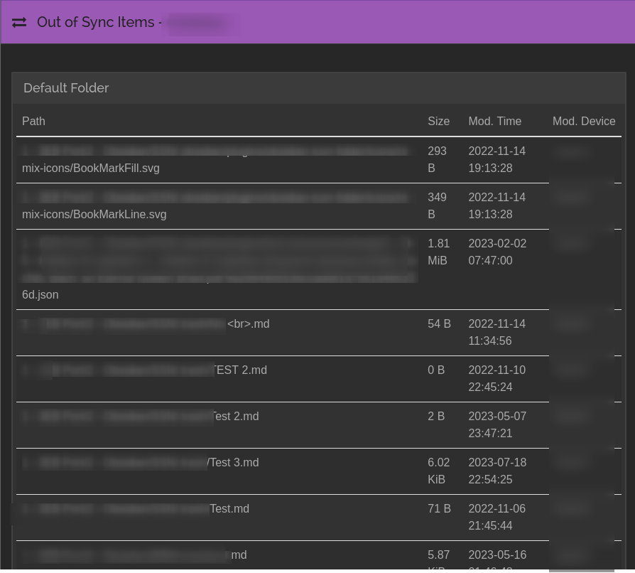

And here are some of the Out of Sync items shown in the Desktop GUI. I couldn’t screenshot all of them because I have to scroll down. But they are all the same, meaning what’s shown in this screenshot is the same below the fold.

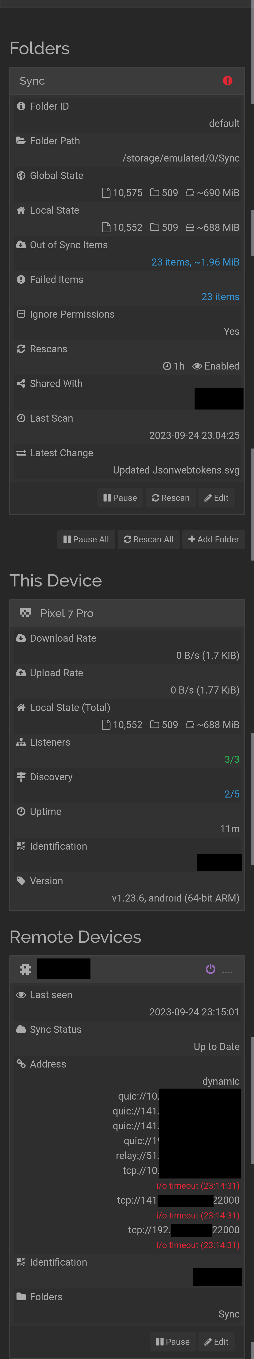

And the Mobile Web GUI is the following:
Thanks for the screenshots! We still need to see what it says when you click on the “23 items” in the mobile Web GUI.
However, from the provided information, I can say for sure that the file with <br> in its name isn’t going to be synced to Android, as its VFAT filesystem doesn’t allow the <> characters.
Ah great, your comment actually made me look into it and indeed all of these 23 filenames included one or more of the non-compatible with Android symbols.
So I renamed all of them, and it’s all good now on that front!
