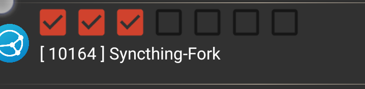

I have had the similar issue. I’m using LineageOS 16 with AFWall+.

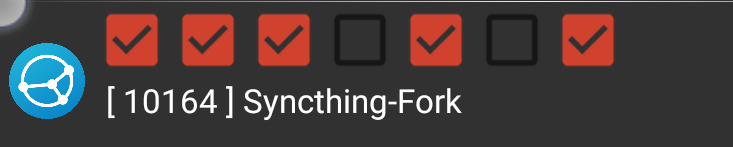

With the permissions above Syncthing didn’t work. I’m not really skilled in iptables, so didn’t try to create custom Syncthing specific rules. Then I just removed permissions for VPN and Tor(I don’t use them too often) , and that fixed the issue. So, now it looks like below:
Now Syncthing works as expected.
