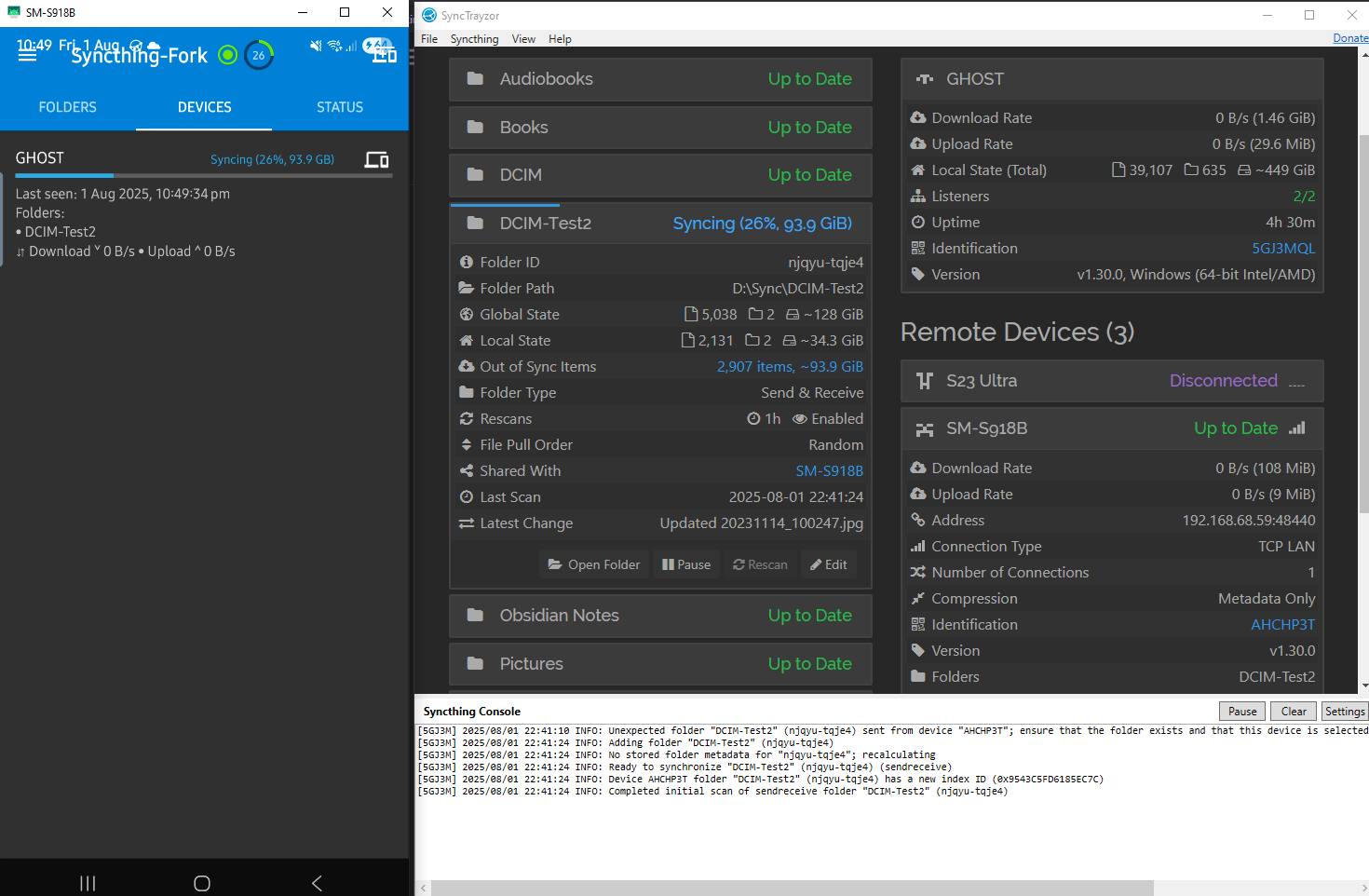

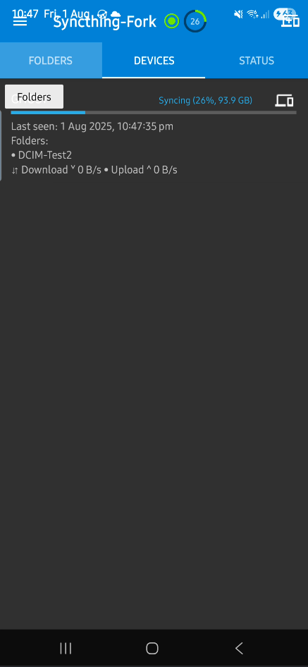

I’d tentatively say it works. It appears to have synced the 50Gb in 15~mins.
  • the Syncing percentage counter increased over time.
  • the transfer speed/total transferred numbers weren’t updating.
  • I need to do another test sync when the folder has finished scanning on the phone. Scan progress appears to have frozen.

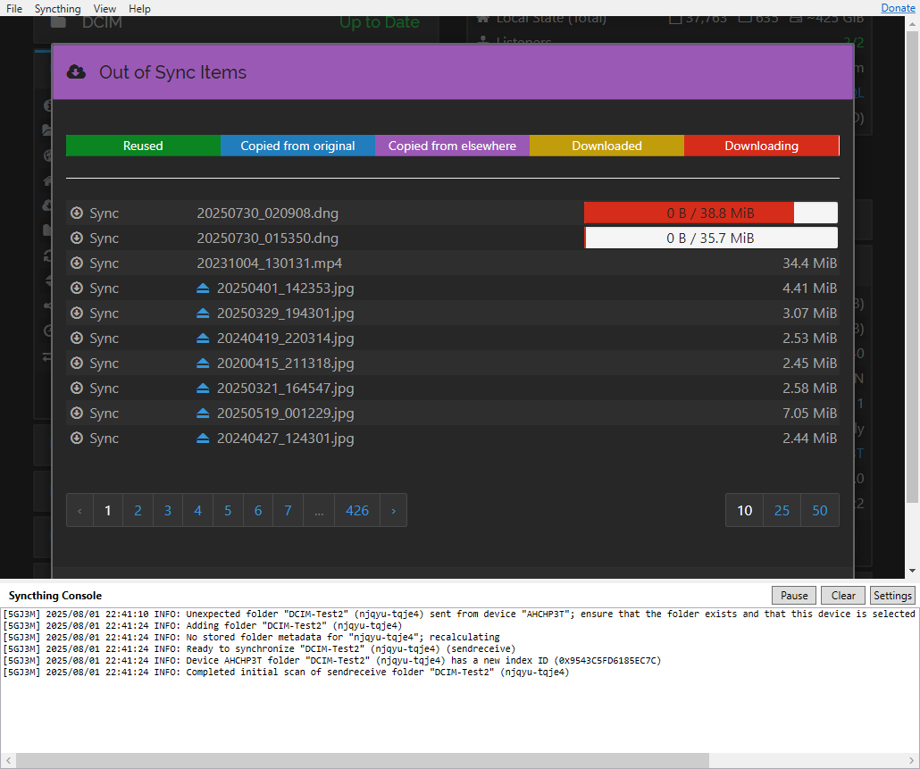

Screenshot of Syncthing-Trayzor on PC:

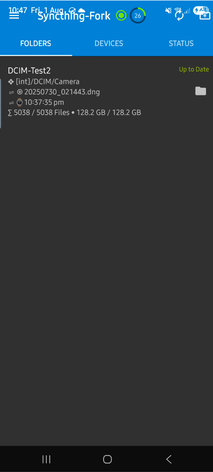

The android application stats appeared to have stopped updating but the file count and total folder size continued to (slowly) increase on the PC side. I stopped the sync and restarted the phone app, then let it finish scanning. It’s now correctly showing the folder stats as image above.

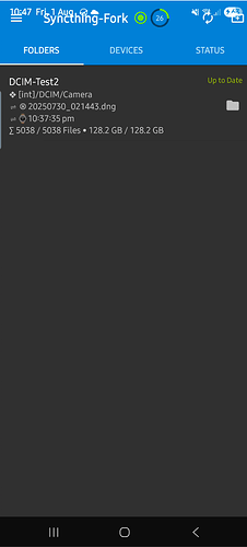

I’ll do a fresh debug APK install. Then:
  • set things up manually, use TCP//IP:PORT
  • let it finish scanning the 128GB folder on phone first
  • accept the folder share on PC
  • see if speeds are reported accurately/if it slows down immediately
Let me know if you want me to do something specific for the test method.

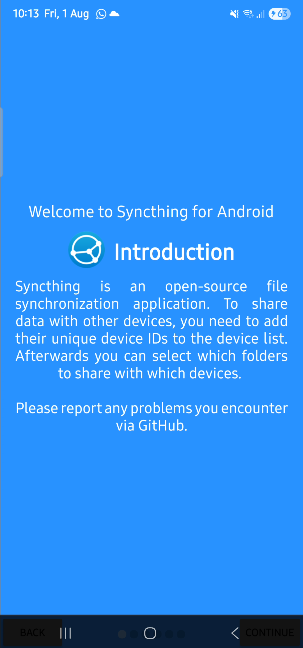

Side note: While testing some versions of the app (including this debug version), the initial setup wizard navigation buttons are covered by the navbar on my phone.
The overlay was a problem in the past for a few versions, yes. Pls try working around by rotating the phone. It is fixed meanwhilst - but because I’d like to analyze the issue I’ve built “an older version like” for you. We can ignore that cosmetic.
No worries, I’ve been getting around it by using multiapp windows :slight_smile:

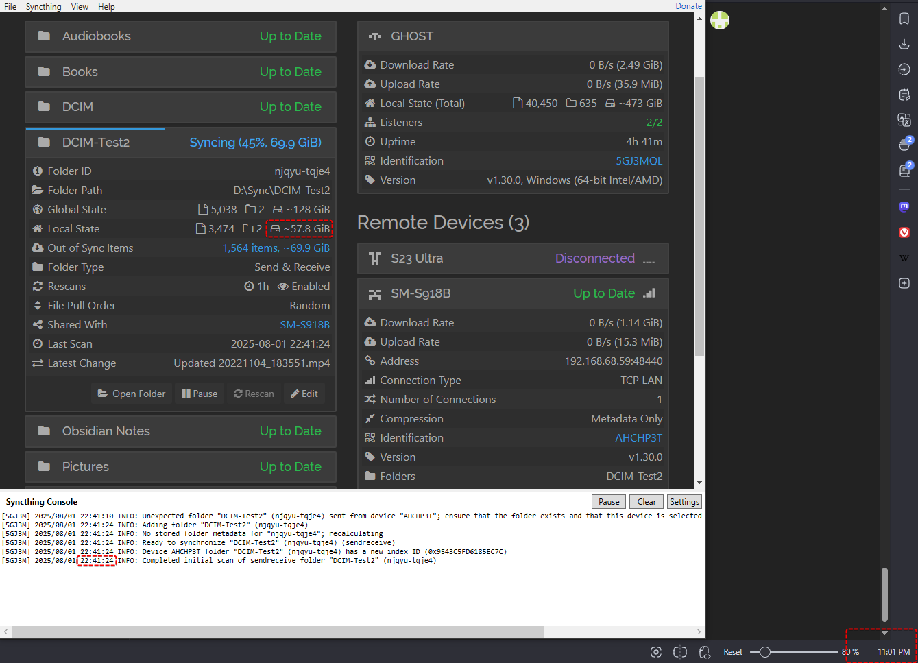

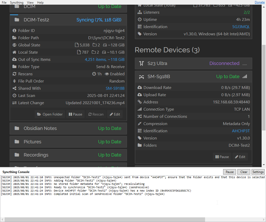

Following the steps above, it looks like the problem persists.
There is an initial burst of speed where 7% successfully transfers, then it stops.
Side by side showing 0 transfer speed.

I need to confirm whether it’s actually stalled, or just perceived to be slow due to the transfer stats not updating.
If we look at this progress screenshot, it appears to have transferred 58GB in 20mins - 48MBps?

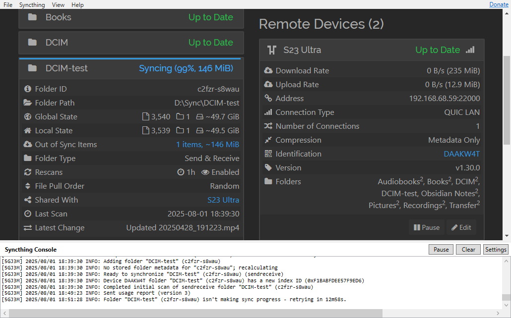

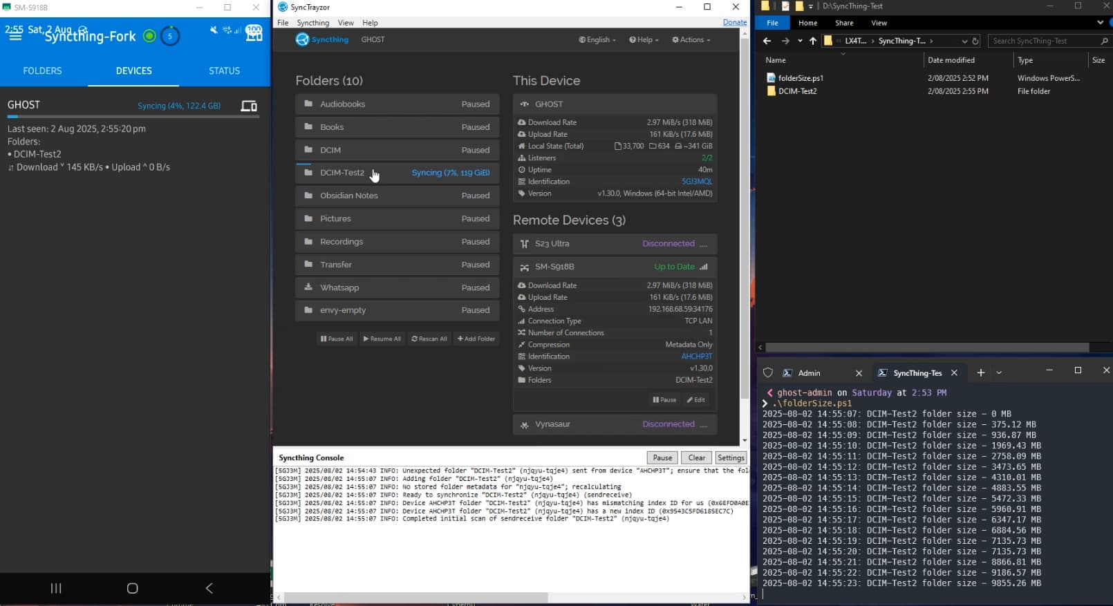

Confirming the data transfer does actually stall. I did a fresh test using the debug apk. It transfers 20GB~ in a minute, then stops. Full log paste attached.
https://pastes.io/syncthingandroiddebug-130090-test2
Android: debug_1.30.0.90.apk
PC: v2.0-rc.23
Appears to exhibit the same stalling behaviour.
16:42:25        0       MB
16:42:26        0       MB
16:42:27        0       MB
16:42:28        0       MB
16:42:29        34.35   MB
16:42:30        376.11  MB
16:42:31        376.11  MB
16:42:32        2118.44 MB
16:42:33        2874.39 MB
16:42:34        3233.71 MB
16:42:35        3625.92 MB
16:42:36        4250.5  MB
16:42:37        4576.41 MB
16:42:38        5035.91 MB
16:42:39        5378.75 MB
16:42:40        5798.36 MB
16:42:41        6310.79 MB
16:42:42        6310.79 MB
16:42:43        6310.79 MB
16:42:44        6310.79 MB
16:42:45        6310.79 MB
