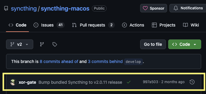

The release version of syncthing-macos bundles syncthing 1.30.0-1. There’s a v2 branch, which may be what you’re referring to, that bundles 2.0.11-1.

There is a v2 branch. The only people using this are advanced testers who found and manually installed it. You can see from my screenshot above that the code references v2.0.11 but @syncthem sees it using, in practice, an earlier version.
