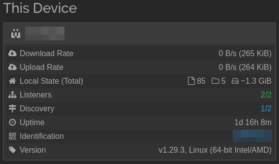

With the download / upload rate counter reset to zero for easier reference, renaming a 544MB file required 264KB of data from a send-only device to a receive-only device:
Upload rate peaked at 4.64 Kbps (with the sync finishing in just 1 second I didn’t have enough time to grab a screenshot).
Since normally two things cannot be true at the same time, either my servers are capable of quantum teleportation (I wish :smirk:), or there’s something unusual about yours.
