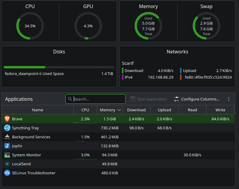

I’m using Fedora 42 KDE Linux, and I started using Syncthing by simply installing Syncthingtray from Flathub and following the on-screen instructions.
Since the upgrade to 2.0+, my RAM usage has ballooned from around 100mb to 700-800mb.
My machine only has 8GB of RAM and it’s really bogging it down.
I spoke to the developer of Syncthingtray and he said it’s likely a problem with Syncthing itself (he says his own instances are only using around 100mb RAM) and recommeded I reach out here.
I’m kind of a noob here, so please let me know what additional info I can provide and how to rectify this.
System info: Fedora 42, KDE Plasma 6.4.4, Syncthing 2.0.2, Syncthing Tray 2.0.0-1

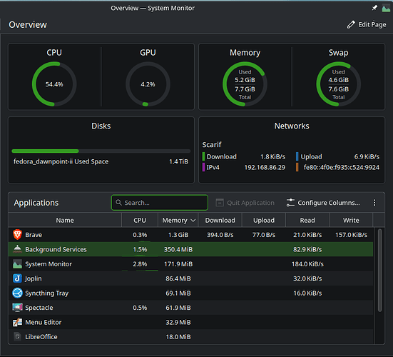

Well this is odd but welcome. I don’t know what might’ve changed but Syncthing(tray) is suddenly down under 100mb of RAM usage again. I haven’t rebooted or anything since last posting here.
Are you still running the same version of Syncthing, or has it in the meantime been updated to v2.0.6?
Same version, nothing has changed. I push off updates for weeks at a time because I leave a lot of work windows open.

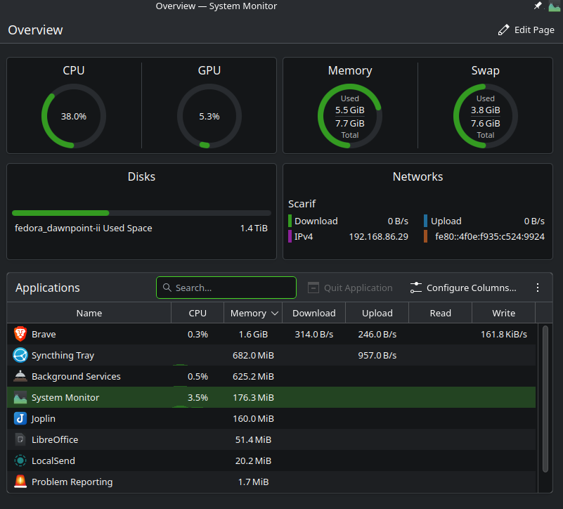

And today it’s back over 600. Closed the lid last night, it was 70. Opened it this morning, it’s exploded again.
Anything else I can do to diagnose this?
Please upgrade to v2.0.7. This version brings major improvements regarding the excessive RAM usage.
