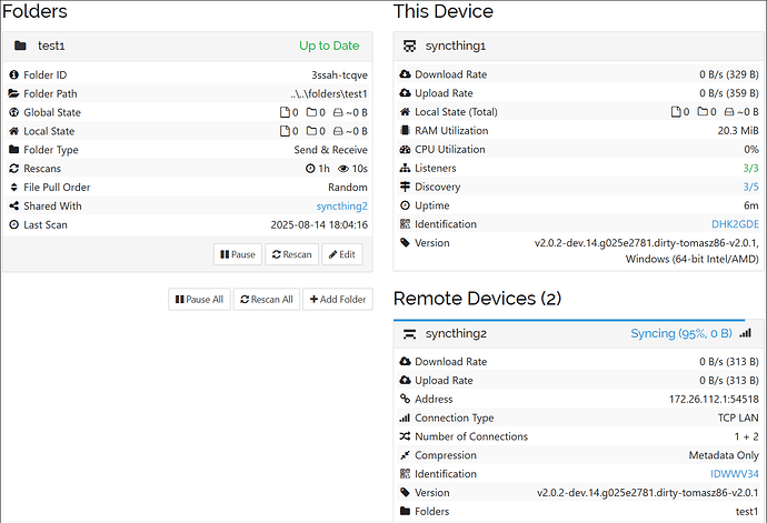

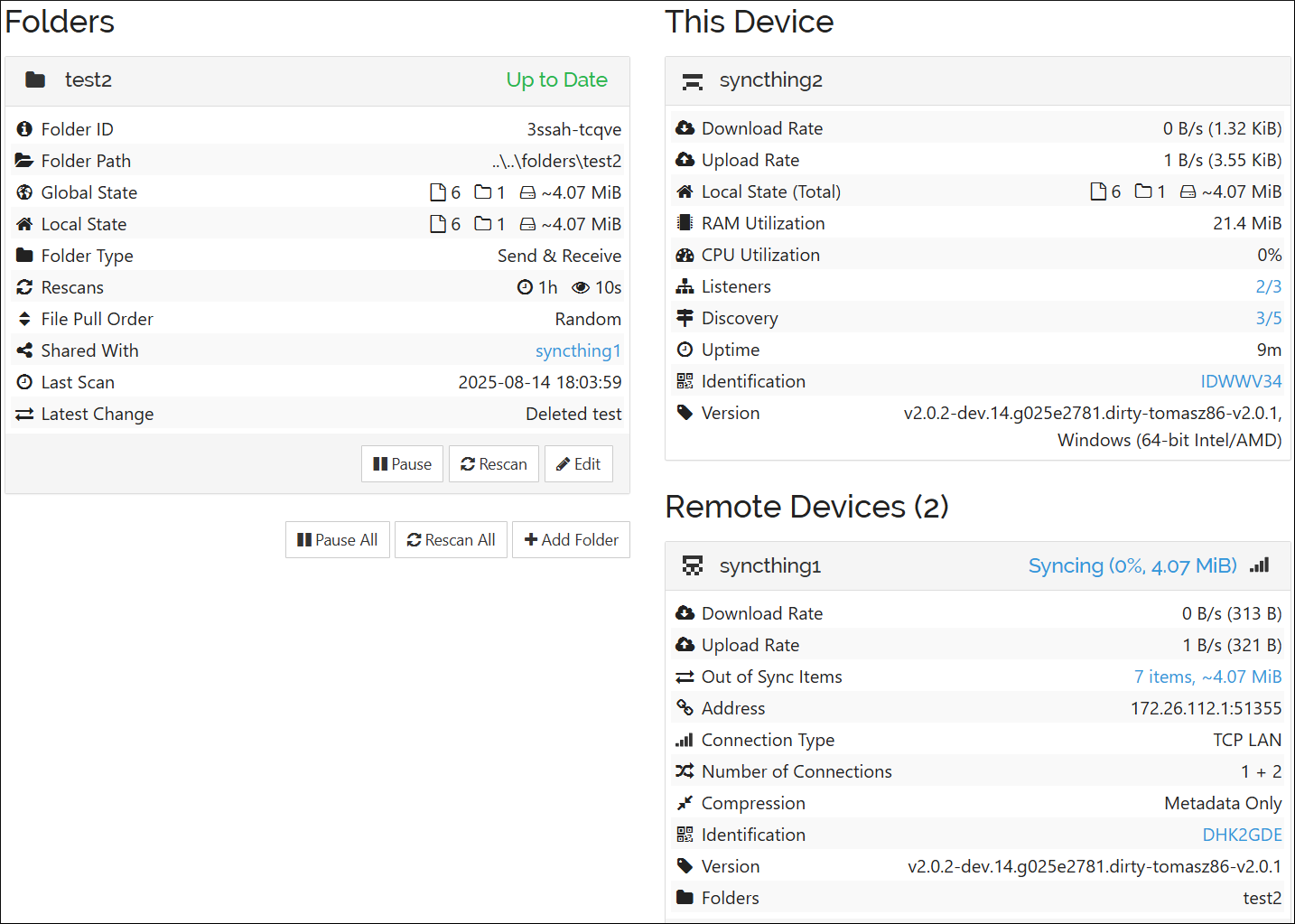

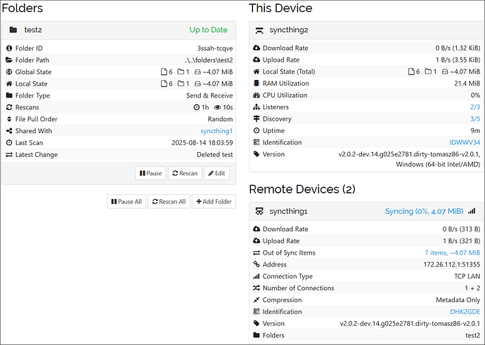

I think Iâve found a bug.
For testing purposes, I modified the source code setting DBDeleteRetentionInterval to 1m and minDeleteRetention also to 1 * time.Minute.
I then did the following:
- There were two devices - A and B.
- I shared a folder with some files between A and B, and let it sync.
- I turned B off, then I deleted the files from A.
- After 1 minute, the deletions were âforgottenâ (according to the log).
- I turned B on again, which connected to A, and then the files were deleted on it too.
- At this point, everything seemed fine.
- I then added the same files to B again, expecting them to be synced to A.
- However, the files are now stuck in sync as below:
Device A:
Device B:
I can do a proper bug report on GitHub with debug logs, etc. if necessary.
That indicates they werenât forgotten. Something else is going on⌠But note also that I pointed out earlier that if the deleted files are the latest in the index, odd things will happen. You want at least some regular changes afterwards for things to make any kind of sense.
Iâd retry this test, but use the actually permitted (now) 24h minimum window, default database cleanup interval, and make sure you have some changes after the deletes. Think of this on the (now) 15 month timescale, not the one minute timescale.
In either case, the interesting debug output is syncthing debug database-file from both sides for an affected file. (Thatâs also the way to confirm a delete is forgotten or not.)
