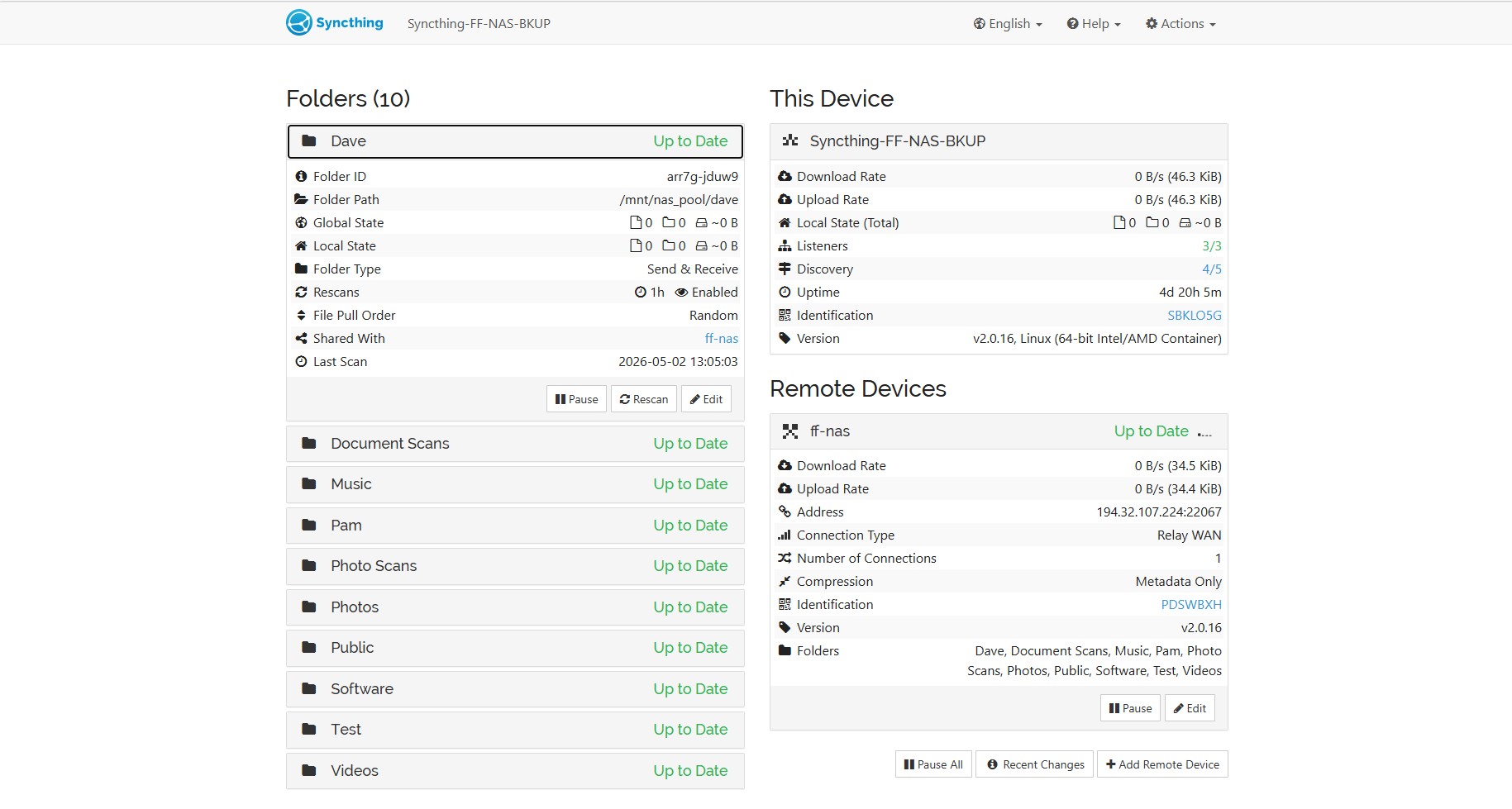

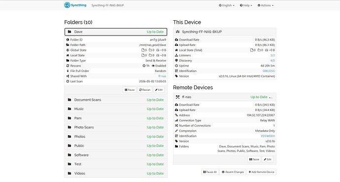

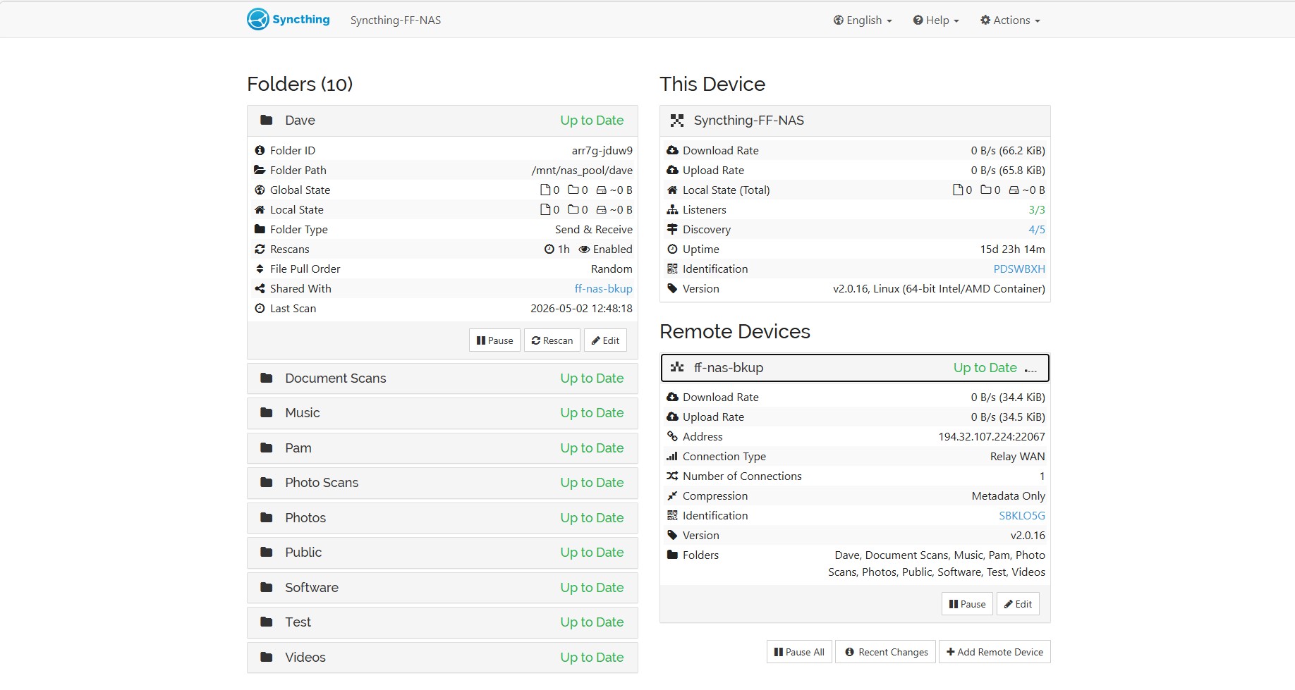

Please post screenshots with the Folder and the Remote Device expanded, on both sides.
These screenshots show the folders I am testing with. The other unexpanded folders behave the same. Thanks for your help.
There are no Ignore Patterns and no visible files. Are you sure 1) That there are files in one of those directories? 2) That the user who owns the Syncthing process can see those files?
That kind goes along with my guesses as to why everything is in sync. This being my first TrueNAS and syncthing installations, I have no idea what user owns the syncthing process. My understanding is that the Apps user in TrueNAS owns it but I don’t know that for a fact. I tried logging into TrueNAS as the apps user (since I couldn’t find an Apps user) and went to a console. I was able to see all the files (147 files/directories) in the /mnt/nas_pool/dave directory that syncthing points to. I can’t say whether the files have read/write permissions, though. It is definitely possible another user owns the syncthing process and I just don’t know who that is.
