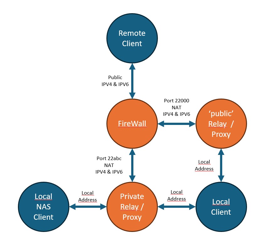

I intent to use the relay for two purposes:
  • as a proxy between the internet and my internal clients and also between internal clients in separate vlans.
  • the firewall should nat te.g. port 22000 to the relay
  • and for extra security since the relay will also use an secrettoken
and of course many devices do not have IPV4 any more and/or use IPV6 by preference
Above the structure for my local Syncthing.
  • UPNP = NoGo
  • Remote client can be IPV4 or IPV6
  • Remote client can be a a really trusted client knowing port22abc and private relay secret
  • An other client using the default port 22000 routed to my ‘public’ relay
Both relays should not be part of any pool (-pool=“”)
The Relays (= Proxy’s) are virtual machines. It would be nice if one VM can full fill all the relay function’s:
  • private relay IPV4
  • private relay IPV6
  • ‘public’ relay IPV4 (future)
  • ‘public’ relay IPV6 (future)
My primary goal at this moment to set up the private part of this concept. Not sure if I will add the ‘public’ part / ‘public’-relay later. I have no direct use for that and I am not sure if I want to add that functionality from security perspective.
