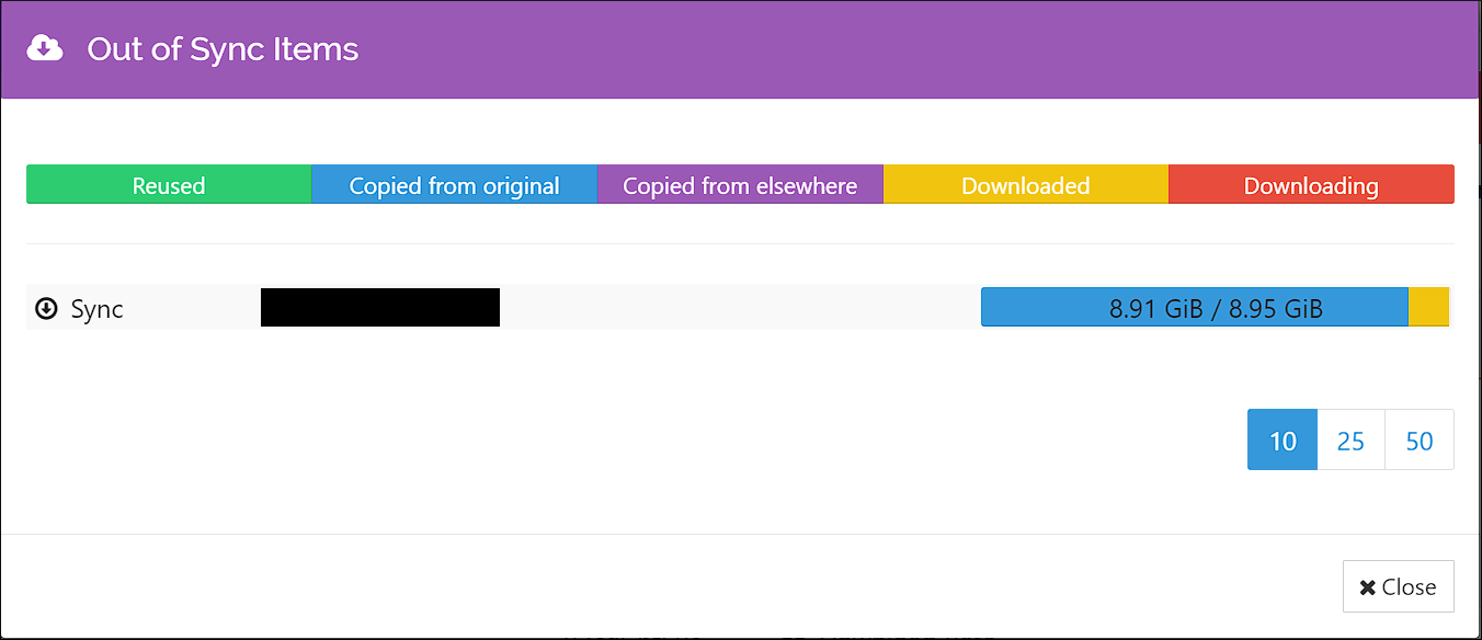

Oh, I was only testing locally without even sharing the folder. This is useless, right?
I’ve now connected another device, let the folder sync, made changes on one side, then synced them to the other.
The GUI did provide some useful information there.
This would mean that ~400 MB have actually been transferred.
Below is a db,model debug log from the receiving side. Is there an easy way to calculate the same number from there?
syncthing.log (231.8 KB)
You can can calculate it after the fact based on debug logs, but as mentioned not beforehand.
