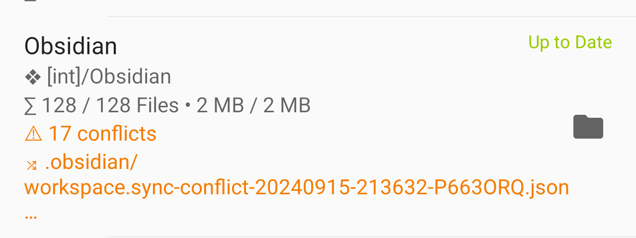

This warning has been present on my Syncthing-fork Android app for months. My files seems fine, but I worry that something is fundamentally wrong and my files will be eventually corrupted.
I just want this message to go away. But on a non-rooted Android device, how do I even edit that JSON file? And the app provides no way to resolve this (unless I haven’t seen it).

Oddly, my sync-conflict files weren’t in the files themselves, but in certain files within the .obsidian directory, like ./.obsidian/workspace.sync-conflict-20250820-104418-BUSXRVZ.json.
Besides workspace, the app and appearance files also had conflicts.
I’m not sure what it means that these conflict files exist, but my files seem fine so I deleted all of them :cowboy_hat_face:
