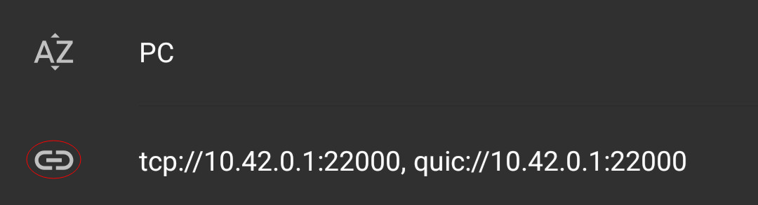

The addresses you set there were the addresses the PC uses to connect to the phone.
For robustness/consistency, you could also set which addresses the phone uses to connect to the PC, in Syncthing-Fork → Devices → PC → Addresses (link icon)
So if your PC’s address is 10.42.0.1, something like this:
