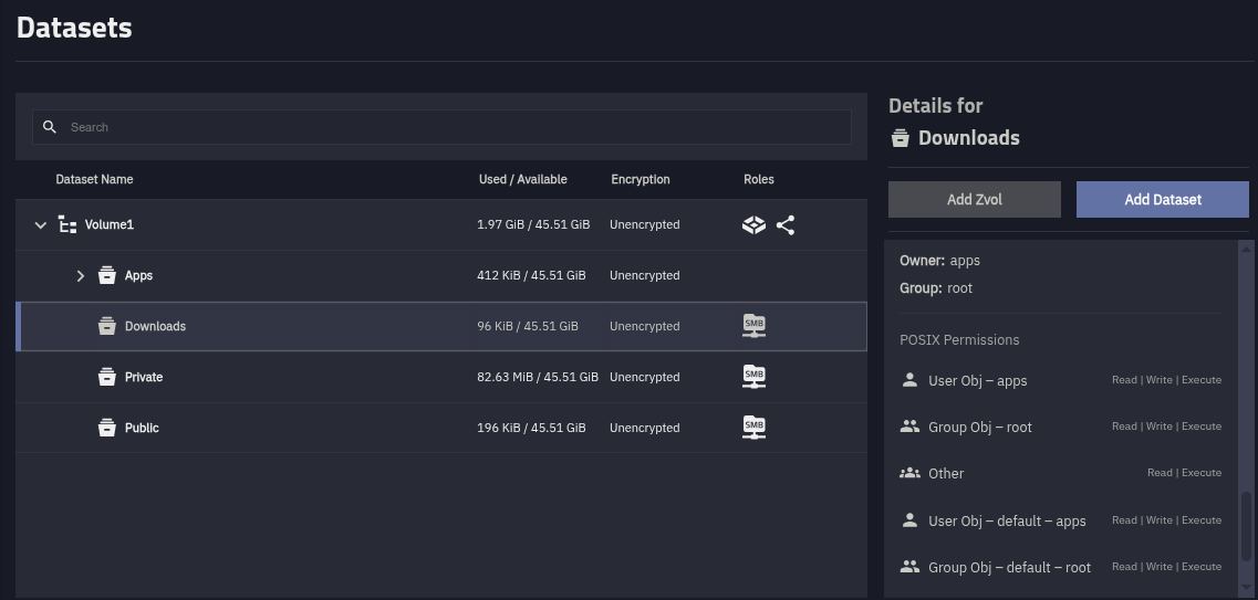

I installed the syncthing from the TrueNAS and shared the dataset using SMB and set the permission.

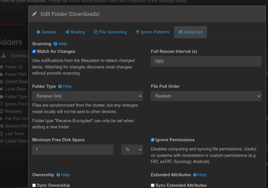

I put the shared path in syncthing like this “/mnt/Volume1/Downloads” not sure correct or not. I also tick the “ignore permission” in the advance setting

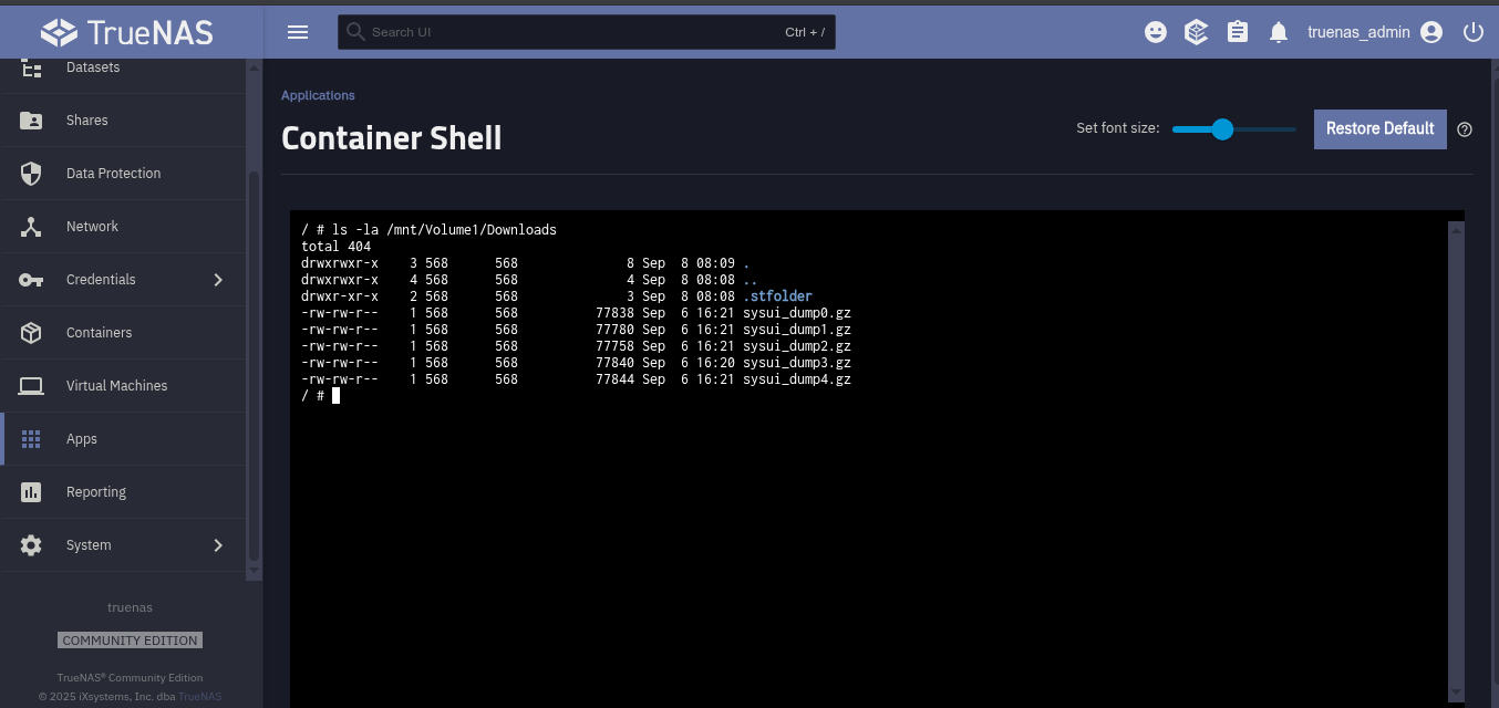

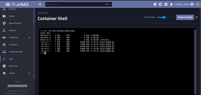

I checked the folder in the TrueNAS shell and the files are in.

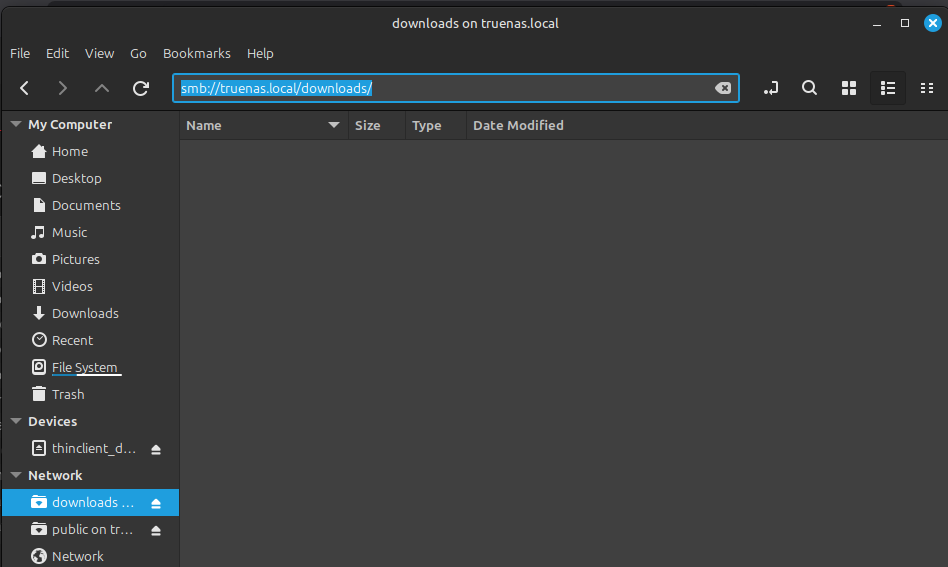

But when I access from my linux vm machine, the Downloads folder is empty.
May I know why and how to resolve it.

Hi Jeffrey,
The key is to think of Syncthing as running in a self-contained computer that happens to coexist inside another computer (your TrueNAS server).
When you created the path /mnt/Volume1/Downloads and shared it via SMB in TrueNAS, your Syncthing container knew nothing about it.
Then, when you configured Syncthing and gave it the path /mnt/Volume1/Downloads, it existed only inside the container – i.e. TrueNAS knew nothing about it.
The missing link is making your Syncthing container aware of the Downloads directory on the TrueNAS side. Because TrueNAS is already sharing the directory via SMB, one option is to mount the network share inside the container using SMBFS in Linux, but much better options are bind mounts and Docker volumes.
So once you make /mnt/Volume1/Downloads in TrueNAS and the Syncthing container point to the same physical location, it’ll work as expected.

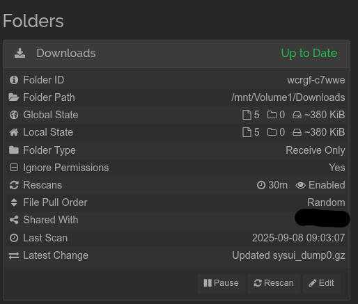

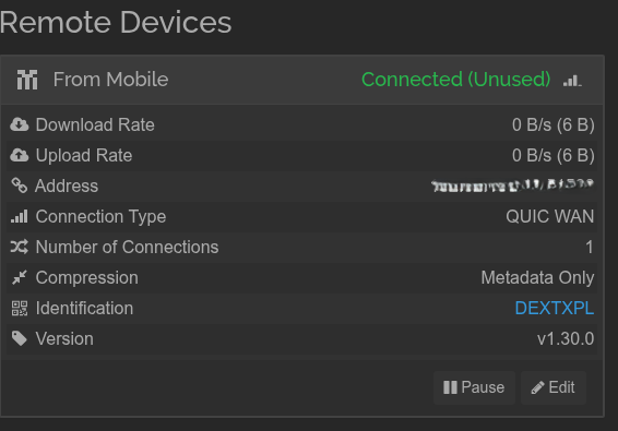

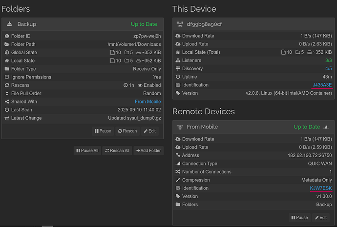

Syncthing. Let’s start with the main page, with a problematic Folder and Remote Device expanded.
Hello chaos,
here is GUI that you requested.
Thank you
~jeffrey
The status “Connected (Unused)” and the lack of seeing any shared Folders on the Remote Device indicates that the two Syncthing Devices are peers but are not sharing any Folders between them. I recommend that you unshare the Folder and reshare it as your next troubleshooting step.

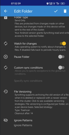

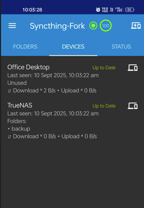

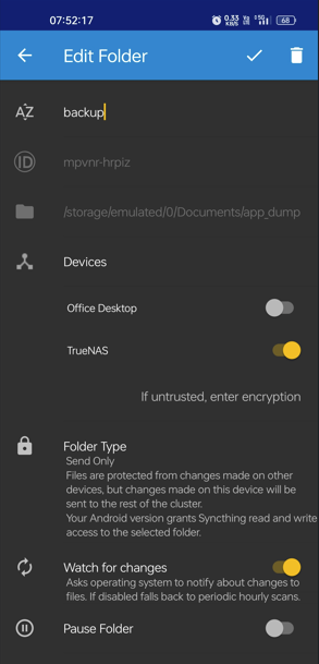

Hi, I am not sure is this that you’re referring to.

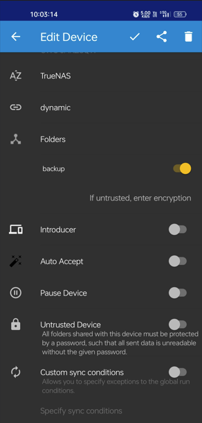

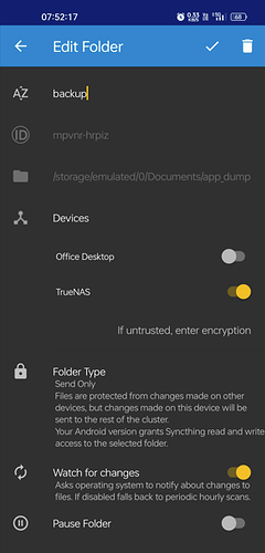

And this are the shared folder from the mobile
Thanks ~Jeffrey
Thanks, that is what I was asking for.
I don’t run Syncthing on Android. With that said it looks like your mobile Device doesn’t have any Remote Devices. I suggest you unshare the Folder on your not-mobile device, and re-share it to your mobile device.
If you don’t see the dialog to accept the share on the mobile device, that’s the next thing to troubleshoot.

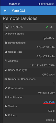

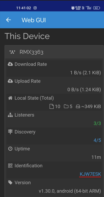

My mobile device has the Remote Devices.
I’m not seeing the same Device name that you have on your non-mobile device.

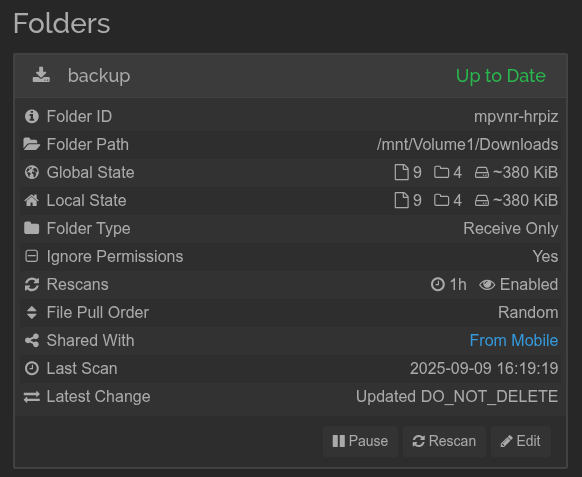

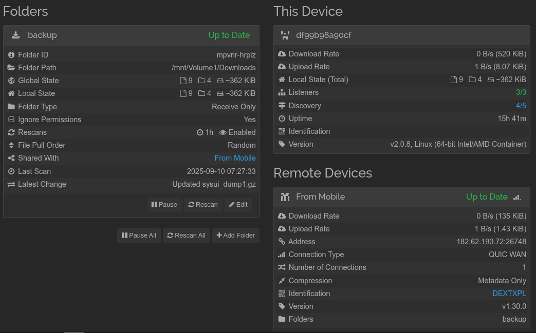

Hi, maybe like this will be much clearer.
Remote device
Hi chaos,
I got it working now. It’s my mistake that I miss out the step to setup the mount path during the installation of the syncthing app.
This below part:-
”In the ‘Host Path’ field, enter the full path to your dataset on the TrueNAS system (e.g., /mnt/pool/documents). In the ‘Mount Path’ field, specify the path you want to use within the Syncthing container (e.g., /mnt/documents). This mount path will be the location you reference when setting up shared folders in the Syncthing web UI.”
Now I am able to see and access those sync files.
