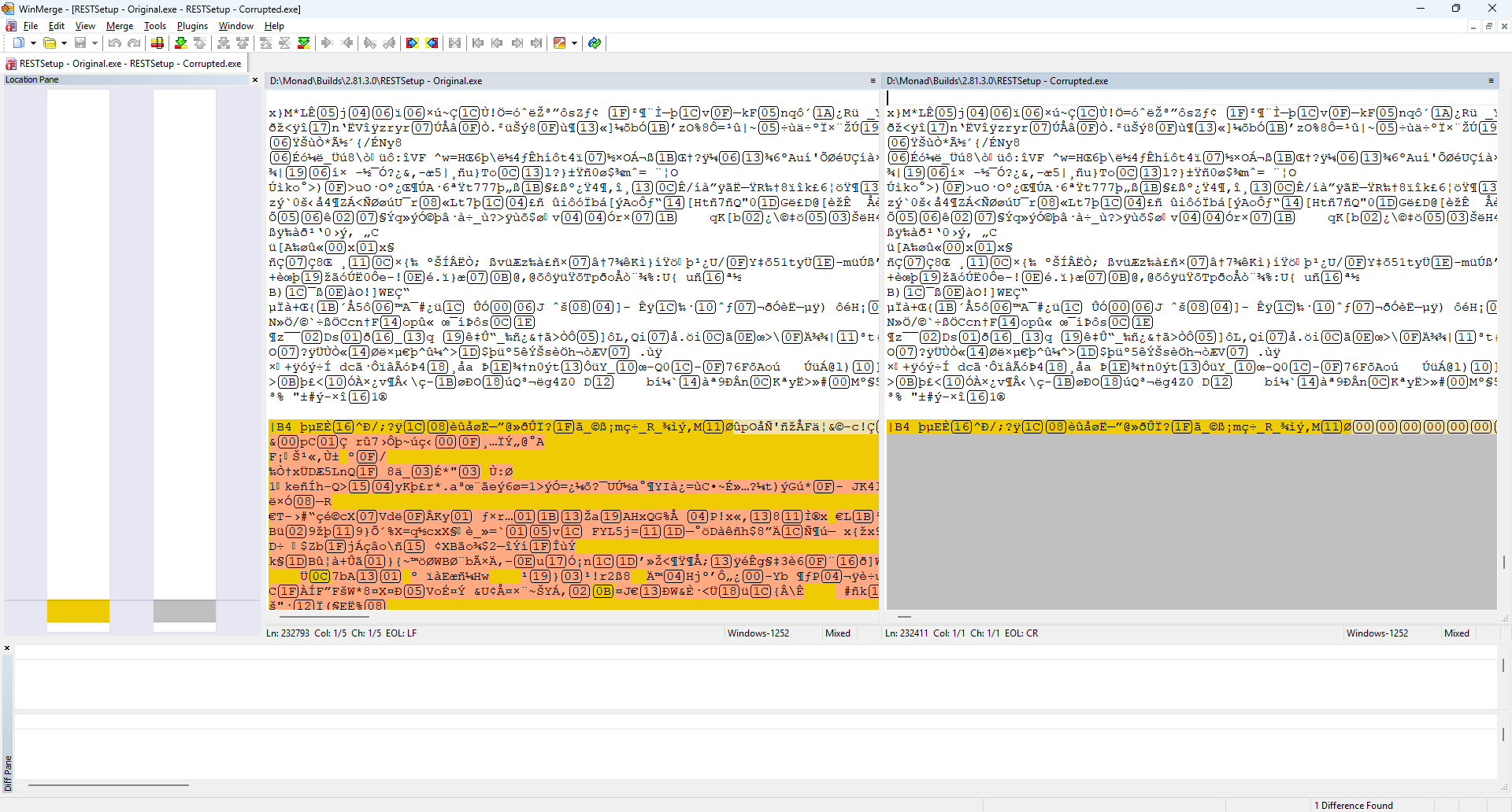

Both files are the same length, but there is a big chunk of zeros at the end of the corrupted version. It looks like Syncthing just stopped early:

The file is 33,332,598 bytes long (that is 0x1FC9D76).
The zeros are not actually at the very end - I misread it.
The zero section starts at byte 01E00000 and ends at byte 01F3FFFF, so it’s definitely a neat chunk, but also there’s a chunk of valid data right at the end of the file.

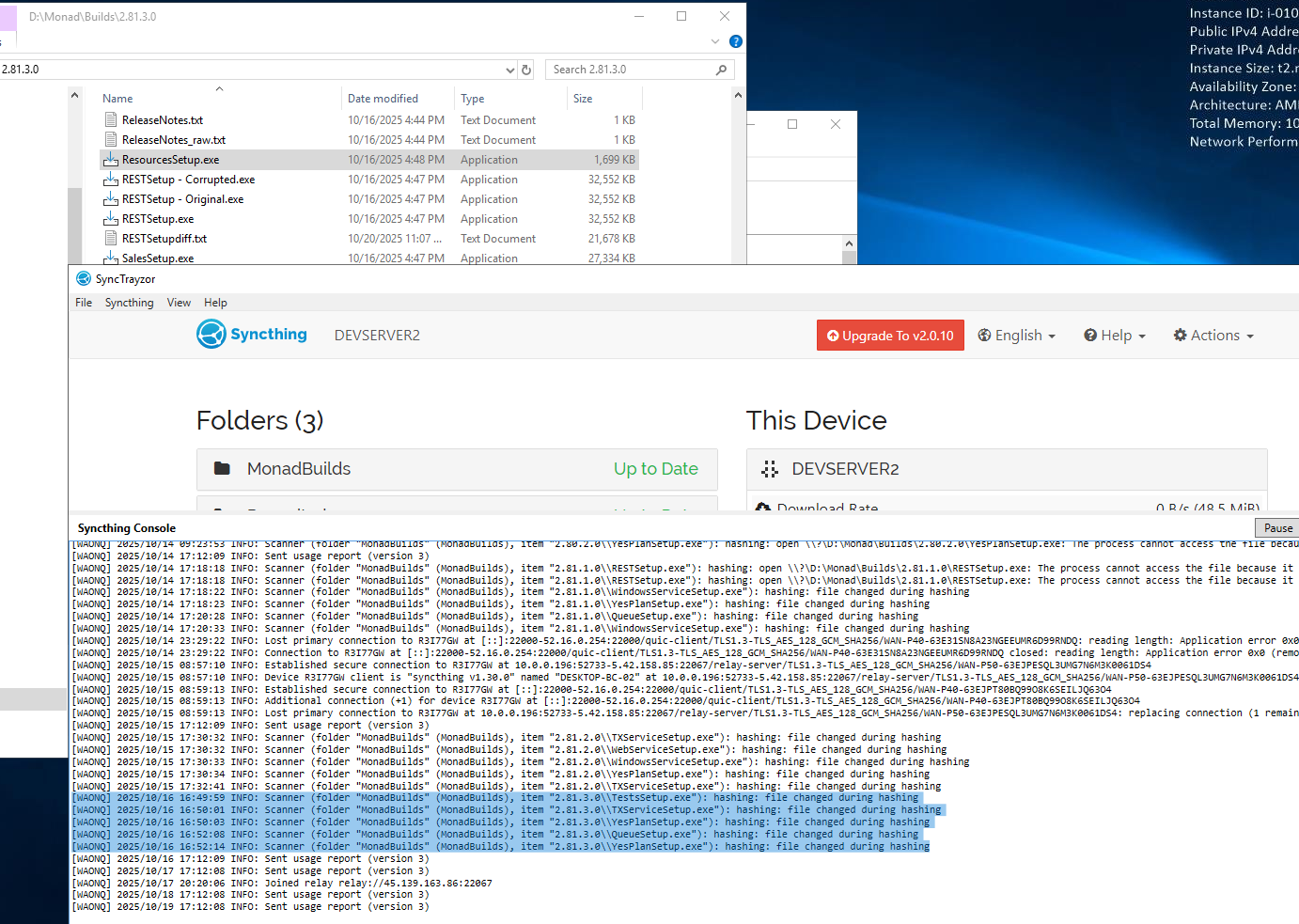

I ran a build and then set the site to update overnight and went home for the day, so it had hours to finish syncing. The version of the file that appeared on all servers was corrupted, not just one, so it was the “sending” server not the receiving one.
The log file complains about some files “changing during hashing” at the time of the build, but that’s normal, and it wasn’t the problem file anyway.
