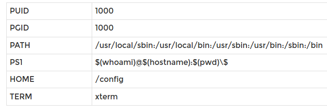

If it helps here is the ENV that I provided to the server side syncthing container:
Ok, this is useful. I think I may have found the issue. I’ll report back if providing the perms work :+1:
