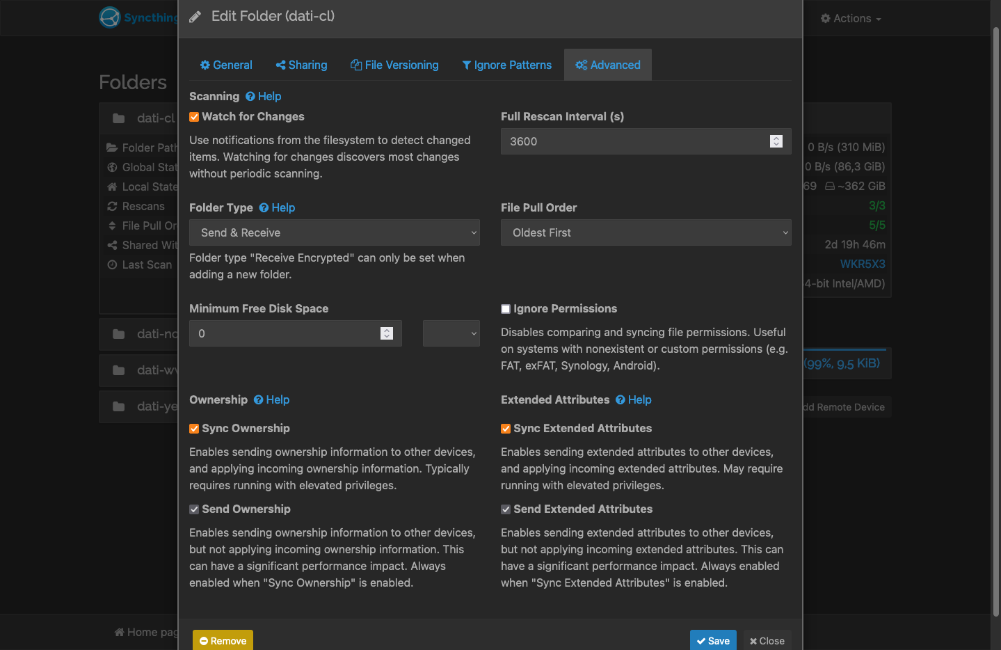

This is the configuration on the primary node:

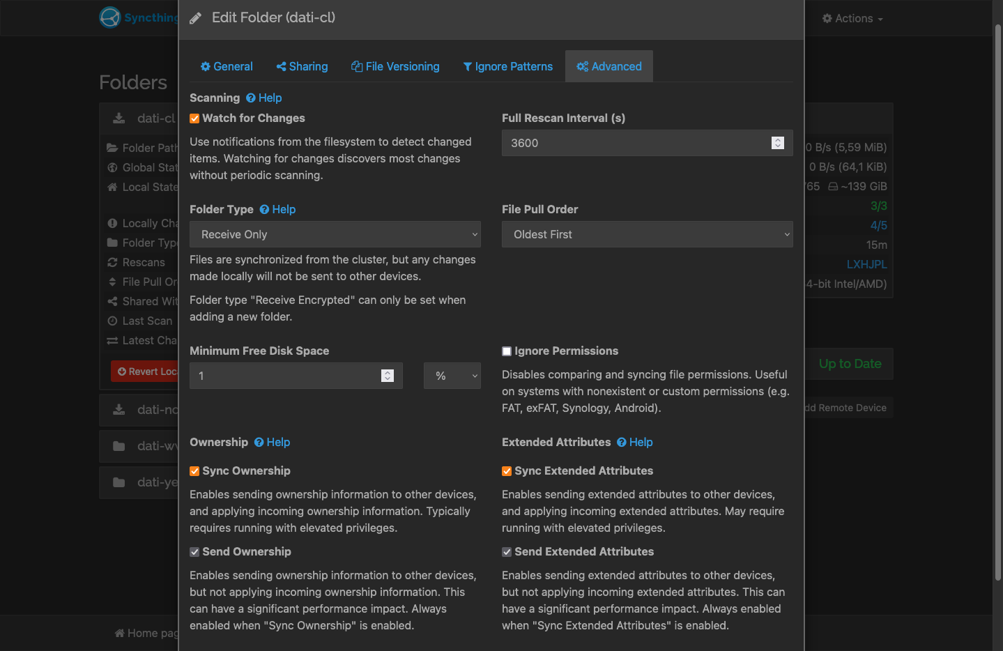

And this on the secondary:

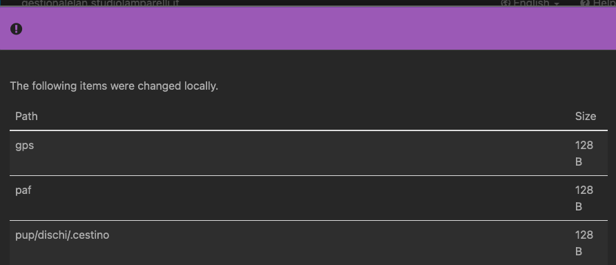

Local changes dialog:

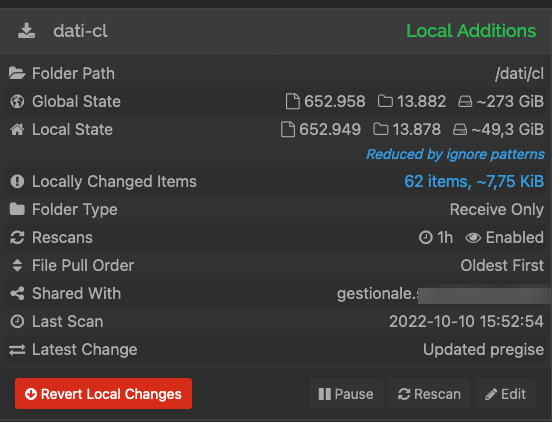

This is the status page on secondary

What I see is odd is that in the local changes list, all listed items have size of 128 B. It’s like an attribute I’m missing…
I’ve had the same problem multiple times, also with Receive Only folders and manually copied pre-existing data. The 128-byte items should be all directories. Is this correct?
The thing is that I’ve never managed to find a fix for this, nor have I been able to reproduce at will in a test environment. The only two solutions that worked for me were either a) set the folder to Send & Receive and let the “changes” sync (which there should be none in reality, but this will make Syncthing happy), or b) start from an empty state and let Syncthing download everything from other devices instead of copying the data in advance.
I have ~90 items, so I haven’t checked all of them, but yes they appear to be all directories. Most of them are empty.
