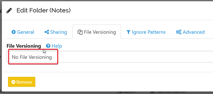

Note: I do not have File Versioning set up on any of my shares
