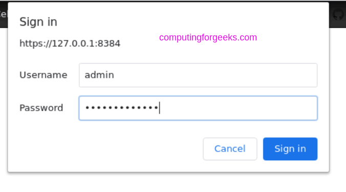

Access Syncthing Portal on CentOS
I have installed Syncthing over the server followed this article
